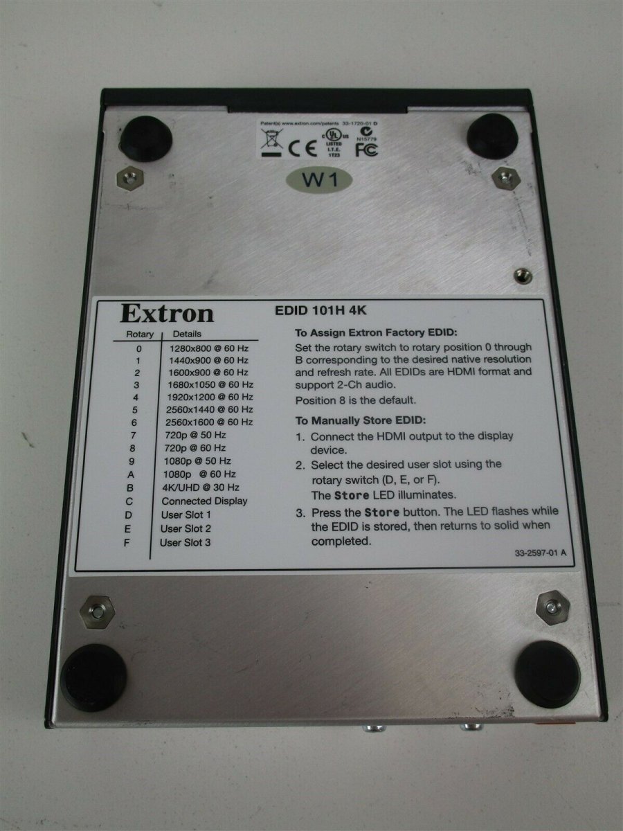

Trying to hook some different systems up to my Viewlex, and hitting the issue that the systems are looking for a HDMI EDID and the LCD is DVI only. Tried various EDID emulators that I have, but none seem to work. Wondering if anyone out there has found a solution.
