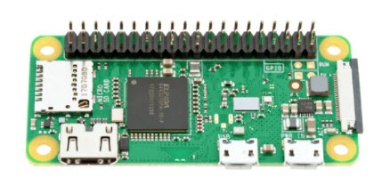

I recommend using a Raspberry Zero W

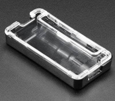

This is the case I am using for it:

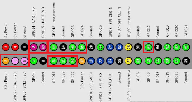

Here are the RPi connections that will be used and connected to the SegaSTV-Pi mult selector pcb
Pins 1,3,5 are used for the OLED display
Pins 11,13,15 are used for the UP, DOWN and SELECT buttons
Pins 8 and 10 are used to send and receive data from the Atmega328 chip
Pins 12,16,18 and 32 are used to program the Atmega from the Raspberry Pi
