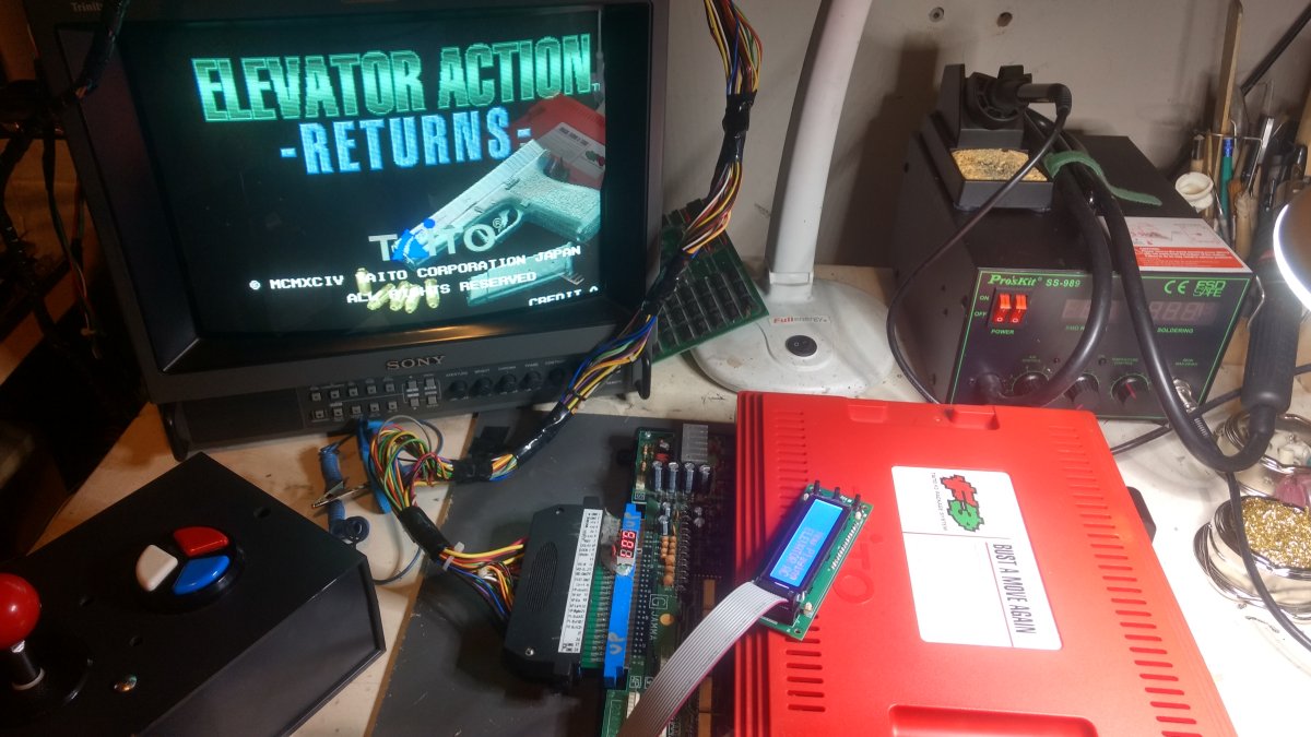

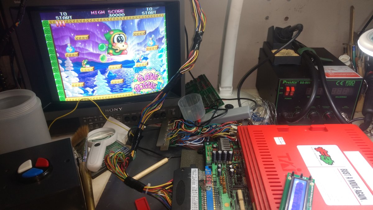

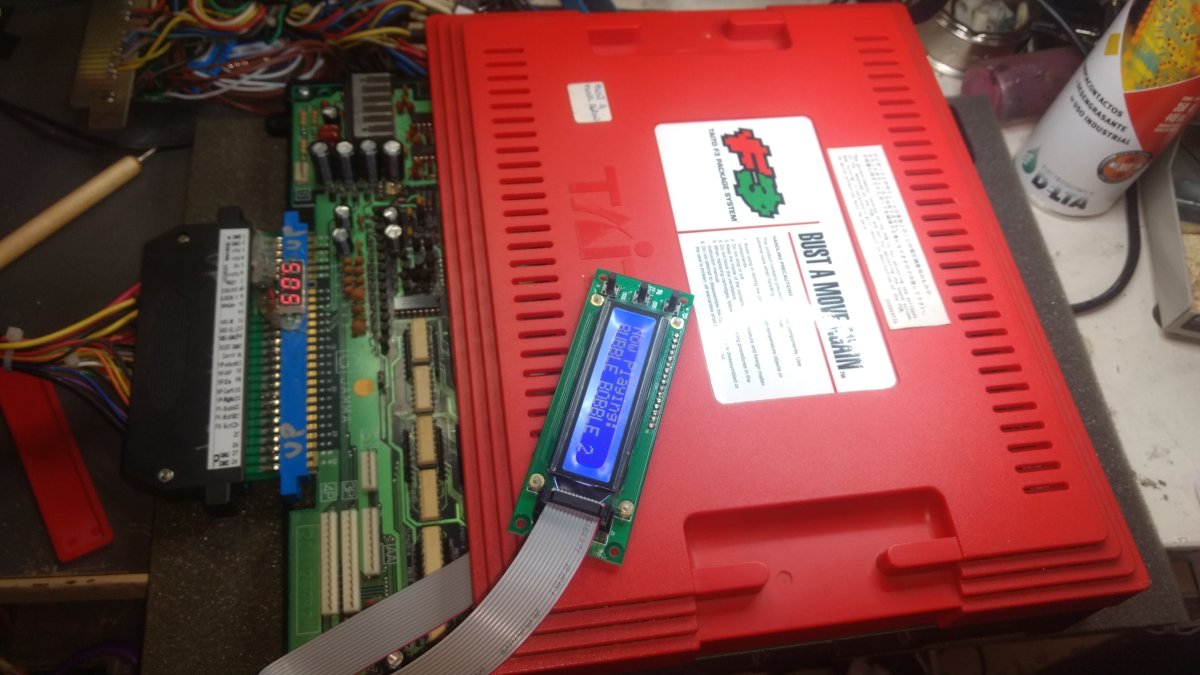

Hi @AlxUnderBase , the mother is working because I used it with another game cartridge recently, the fan works, I attached photos when it worked.
