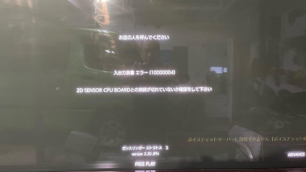

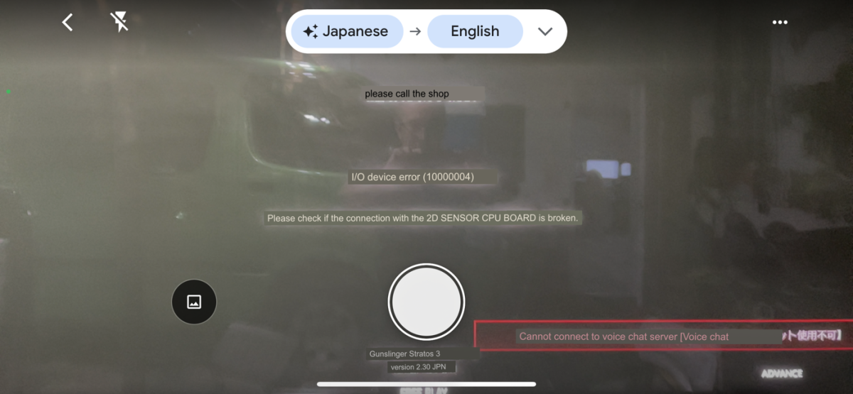

Gunslinger Stratos 3 Error?
hmmm... I've swapped both gun boards already and the fast i/o and still had the issue. The bios in the new x3 I have is v1.0b16, wonder if that is why it might not be reading the hd?
I also installed a multi in it to test and change the bios, some of the controls on the guns work on the multi, but all the others are disabled.

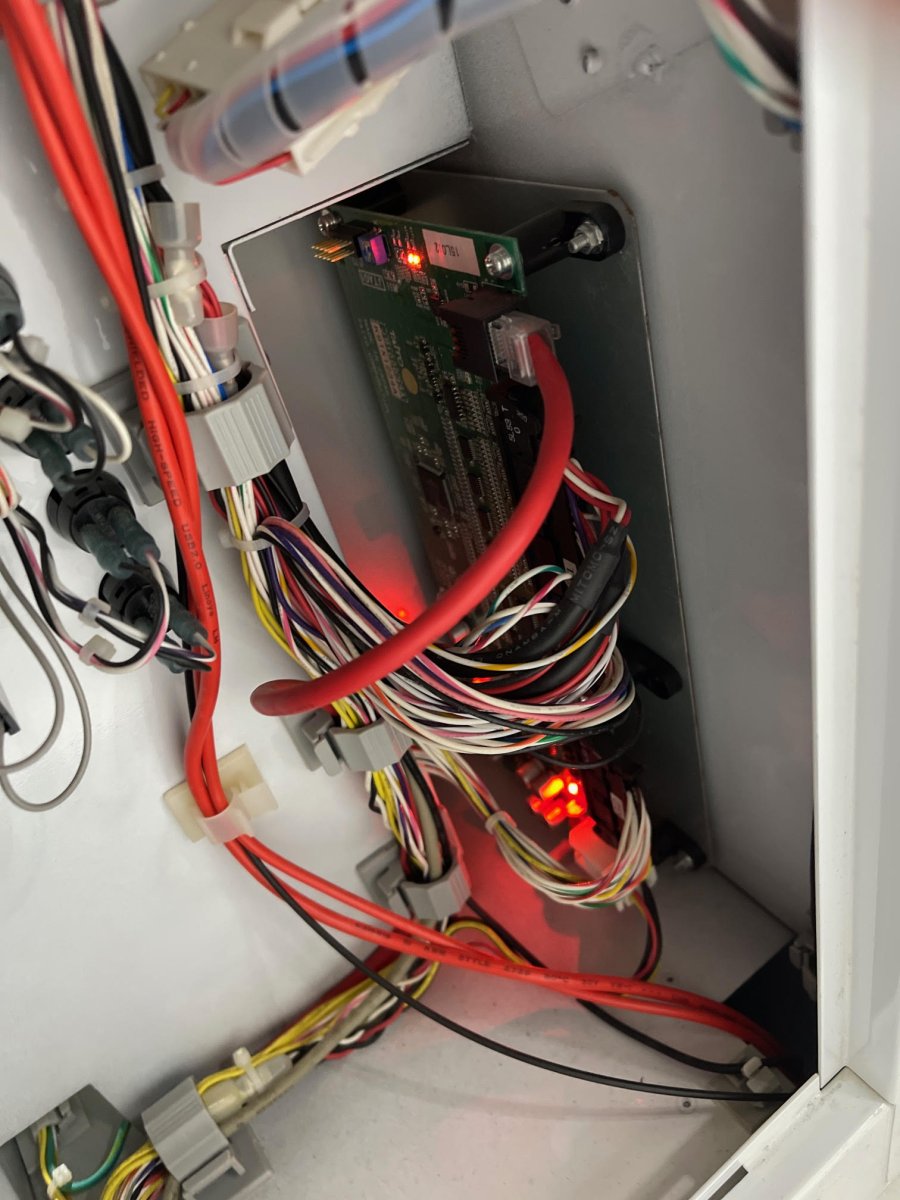

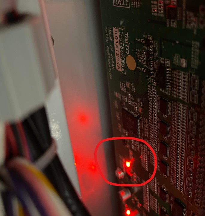

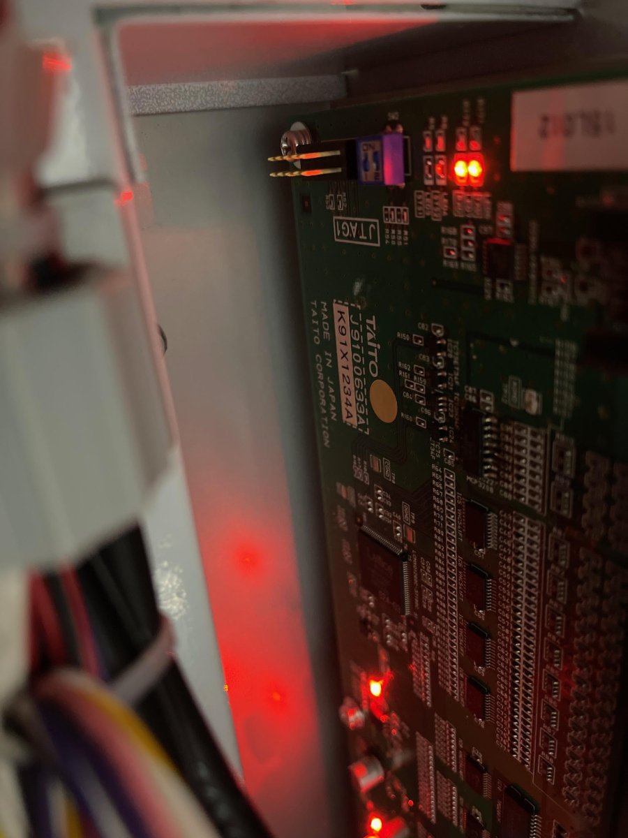

Guns work in test mode, nesica card reader works, ive swapped guns, swapped gun boards, swapped fast i/o, took apart the 2d sensors and reconnected them all.
