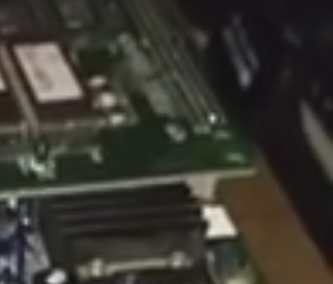

This is the 27c1001 or 27c010 you should check. If not , maybe somebody with repairs experience knows what to tell you ✌️But , its fixable
