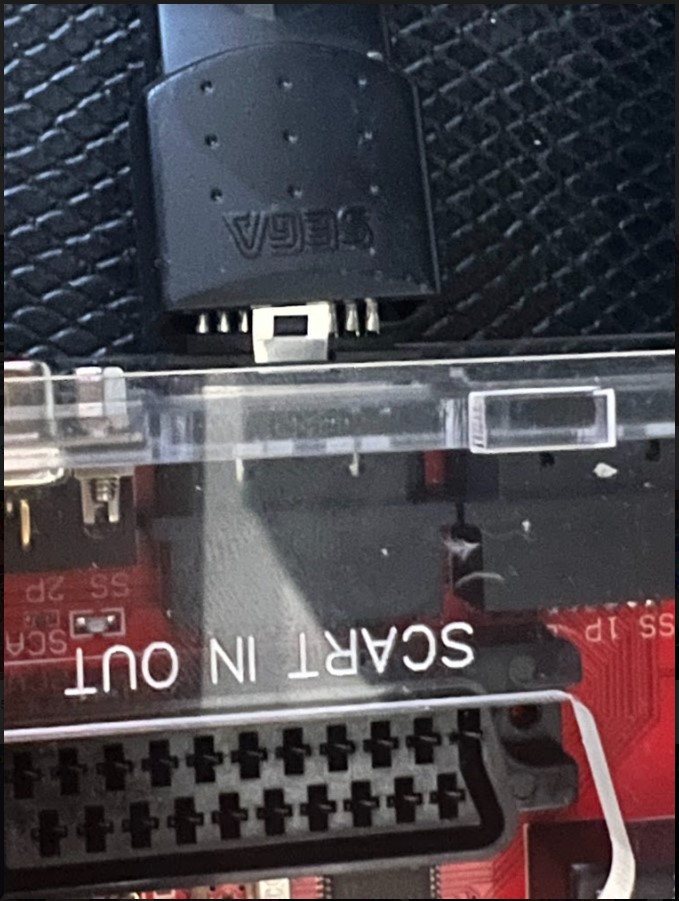

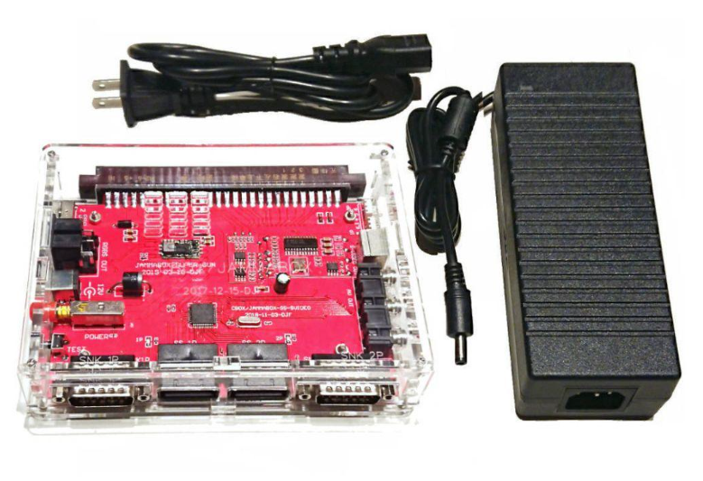

Got pictures of the setup? There are a bunch of different makes and models of these at this point...
The third pic is the issue where button 4 doesn't turn on. Then the other 2 are of my supergun that I run.
