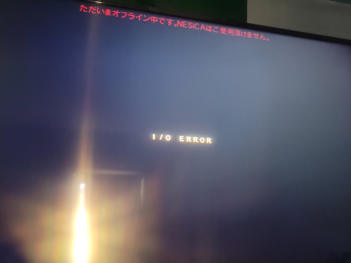

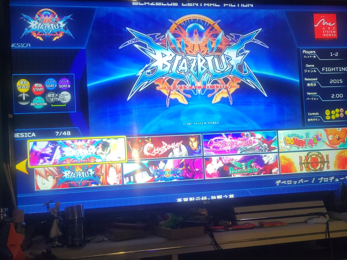

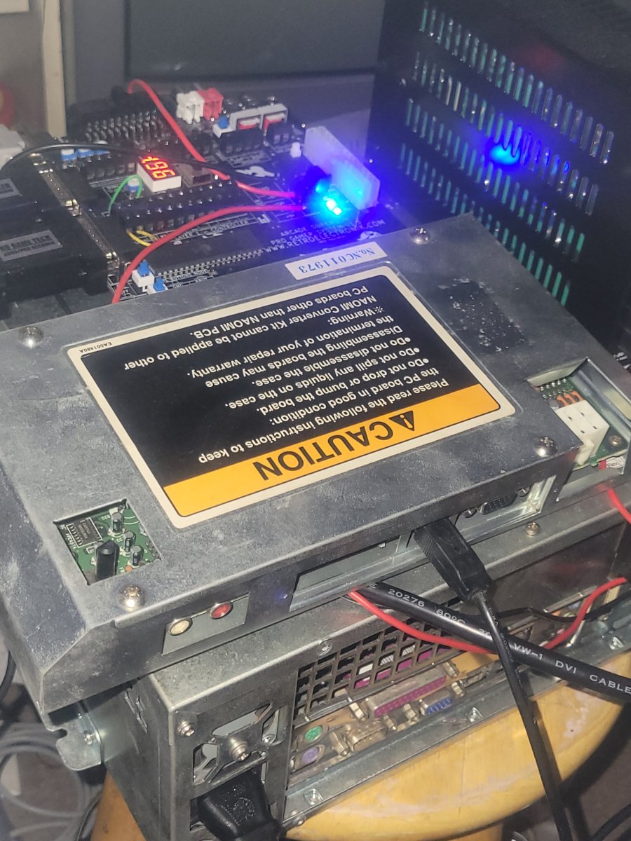

On the Taito X2 multi i attempted to boot up Blazblue Central Fiction on the frontend and got met with an I/O error. This applies to the other Blazblue games as well, i looked through this topic in other boards and i hear removing "iDmac controller card" fixed it? I don't know where within the taito the card is. Any advice?

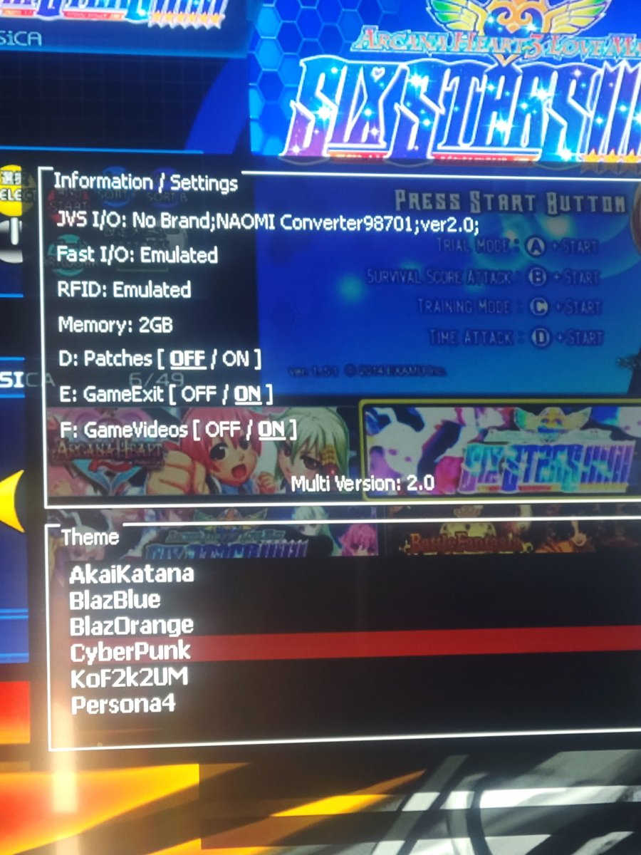

Likely BlazBlue just doesn't work with the Capcom IO.
Well no, you don't need Fast IO for Nesica titles. JVS is fine. A Taito Vewlix JVS IO will be the most compatible, but a Sega one should be fine too.

I have a sega and capcom I/O board and i tested both. The system said i/o errors. Both are jvs so im at a loss aside from getting a fast board
Works fine for me with Capcom I/O (CT, CS,/2). Never tried the Nesica titles but I can't imagine they wouldn't work with Fast I/O emulation/RFID enabled. I can try tomorrow I guess and report back.

Yeah. It's strange in the images are the capcom boards. The only Blazblue game that works with the JVS is Continuum Shift as it wasn't in the Nesica loader.
What version of the X2 Multi are you using? I had a older version and faced similar issues, and fixed it by upgrading to the latest.
