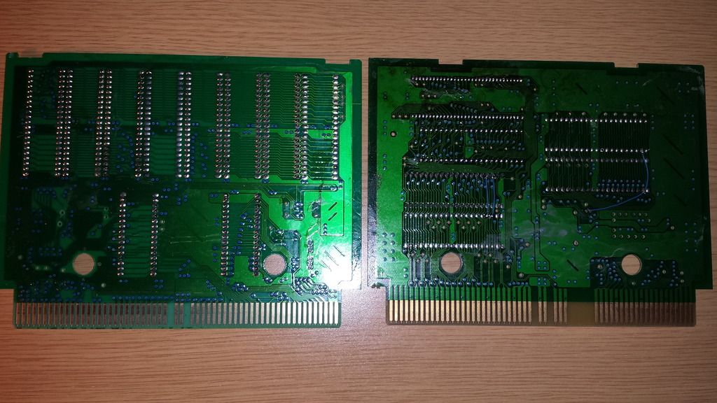

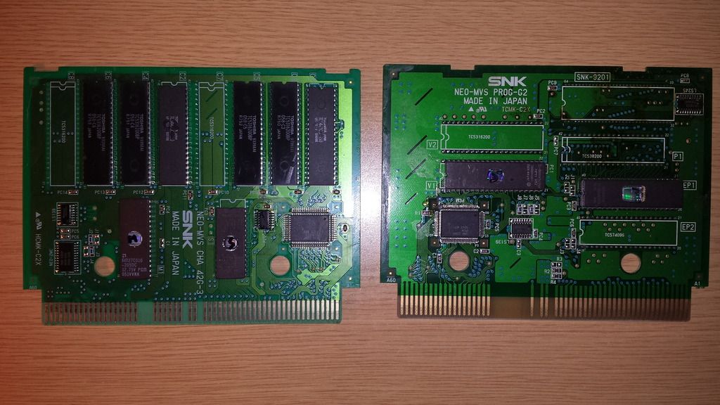

I have a bootleg Puzzle de Pon! MVS cart that I'd like to turn into a 2-in-1 Puzzle de Pon!/Puzzle de Pon! R cart where you can use a switch(?) to change between them.

Actually, what I think I'm going to do is see about just converting it completely to Puzzle de Pon R.
It seems to be easy to build, only different roms are P1 and S1, the rest seem to be the same.
